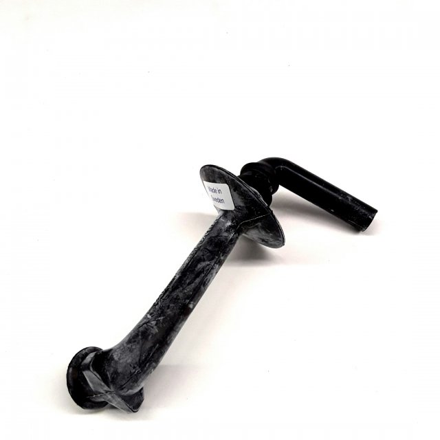

I get a flood in the passenger side every time we have a downpour. I checked the sunroof drain pipes - everything looks good. The next thing I checked was the ac evaporator drain tube - the part of the hose that attaches to the fire wall is loose. Not sure how that happened but I tried pushing it in, but it wouldn't move. Does anyone know how to reattach the evaporator drain tube to the fire wall? The part that attaches to the evaporator is secure.
