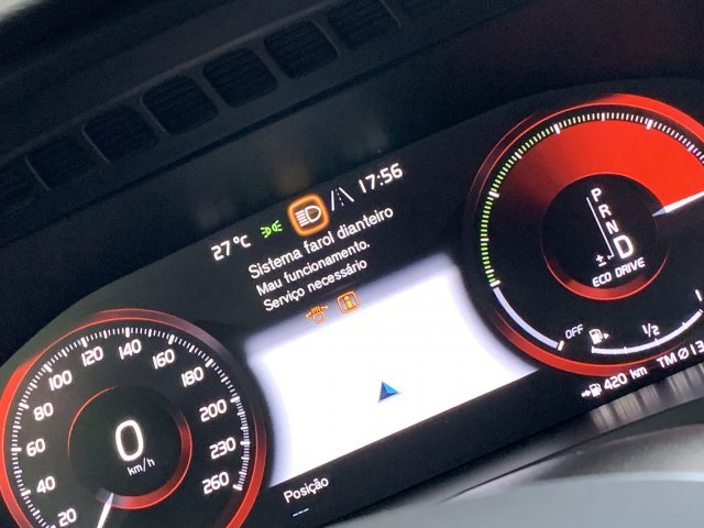

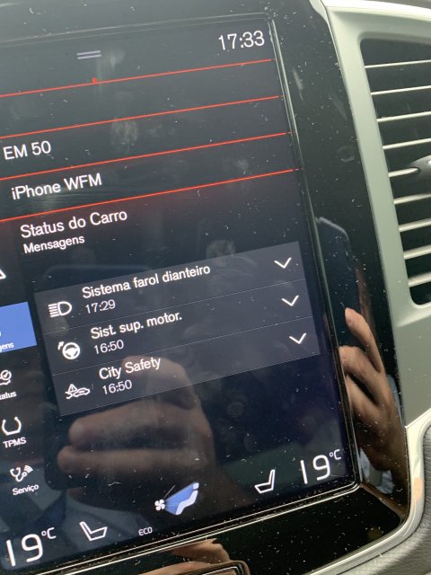

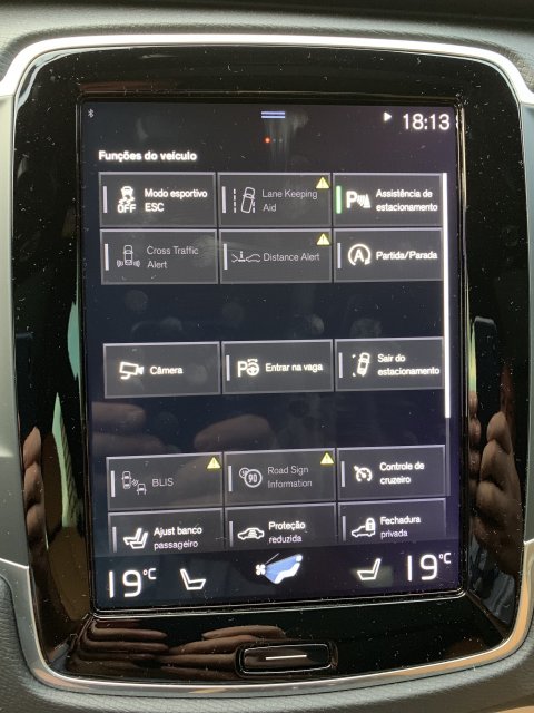

Xc90 momentum 2019
#3
Problem:
XC90 momentum 2019 - Software issue/ head lights stop work and a broken sunroof.
Did they resolve the problem?
Software - yes
Sunroof - no
Details of repairs / diagnostics:
Updated Software.
Mileage:
2000 km
